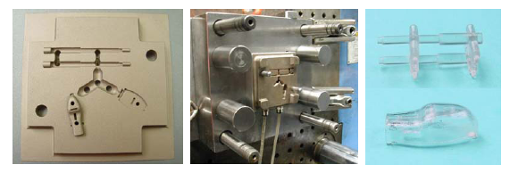

Figure 1: Series production of an LED light guide in polycarbonate.
Left: DirectTool insert. Middle: completed injection mould.
Right: moulded parts. Courtesy of EGi, PAKTO
In this case the requirement was for series production of two small plastic components in polycarbonate. Although fairly simple, conventional tooling would still have required EDM work. Using an EOSINT M 270 system, the core and cavity were built in just 5 hours 40 minutes. No post-machining was required, the finishing only involved shot-peening and slight manual touching up. The core and cavity were mounted directly onto the injection moulding machine, and production was started. Only six days were needed from project start to series production.
