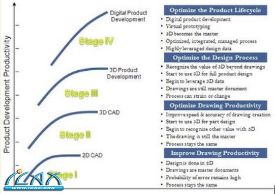

Recently I have been talking with several companies about the possibility of reducing their dependency on fully detailed drawings. In a recent post titled “The Maturity Curve of Product DevelOPMent” I used the following chart to show the different stages that companies go through as they learn to leverage their electronic CAD data deeper and broader into the product development process.
最近我一直在与几家公司谈论关于减少对对详细的二维图纸依赖的可能性。在最近标题为“产品开发的成熟度曲线”的文章中我用截取了下面的图来表示企业在不同阶段,通过学习不断深化拓宽产品研发中电子CAD数据的运用。

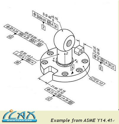

Recently, Matt Lombard at Dezignstuff.com asked if any of his readers were using the 3D CAD Standards that are laid out in the ASME Y14.41 standard. This standard basically defines how 3D models are to be documented and annotated to fully represent the complete definition. So far he has not received too many responses, and no response that indicates the use of this standard and MBD.
基于模型的定义(MBD)是用来描述除了三维模型外本身之外的信息,比如说表示零件和装配的完整定义。对于大多数企业来说,这个完整的定义通常是利用二维工程图和其他相关文档。实际上有很大的可能性,MBD可以使人们减少甚至抛弃对二维图纸的需要。
最近,Dezignstuff.com的Matt Lombard问他的读者是否有人在使用基于ASME Y14.41标准的三维CAD标准。这个标准基本上定义了如何记录和注释3D模型以便充分表示出其完整定义。到目前为止,他并没有收到太多的反馈,这也了表明了这一标准和MBD使用情况。
