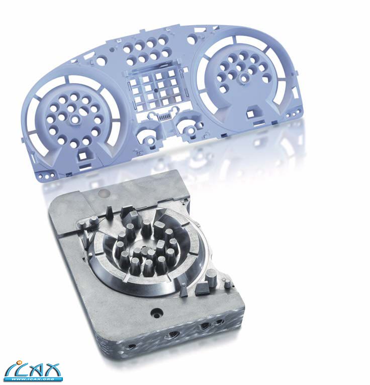

In this case the requirement was for series production of two small plastic components in
polycarbonate. Although fairly simple, conventional tooling would still have required EDM
work. Using an EOSINT M 270 system, the core and cavity were built in just 5 hours 40
minutes. No post-machining was required, the finishing only involved shot-peening and
slight manual touching up. The core and cavity were mounted directly onto the injection
moulding machine, and production was started. Only six days were needed from project start
to series production.

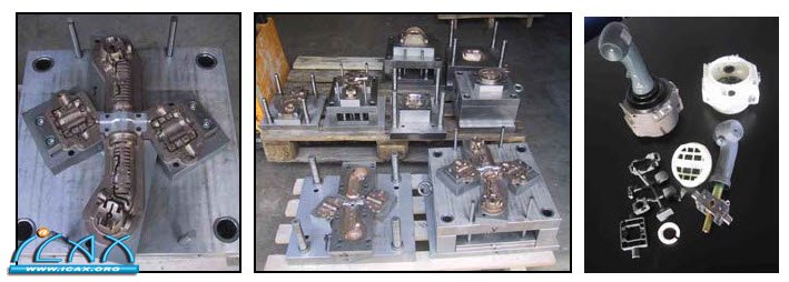

Figure 2 shows a much more complex project, which was performed by FIT GmbH.
