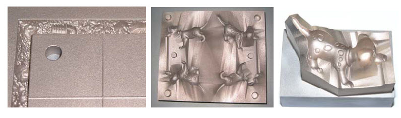

DirectTool is used to produce tooling for highly intricate parts, which would otherwise
involve extremely complex tool path generation and machining. Figure 3 shows two
examples. In both cases, the series production tooling was made by DirectTool and required
no post-machining. In the case of moulds for rubber or elastomers which include undercuts,
these can be easily built by DirectTool without additional effort, whereas undercuts typically
involve increased complexity for machining.

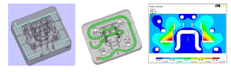

The best known way of improving tool performance using DirectTool is by optimizing the
design of cooling and/or tempering channels to enable lower and/or more uniform
temperatures in the mould, or more rapid cooling and/or heating. This can reduce both cycle
time and also scrap rates due to stresses and warpage. The result is typically increased
productivity and reduced cost per part in production. With conventional machining, cooling
channels are added into a tool by drilling, which restricts the cooling design to combinations
of straight lines, which must all be accessible for drilling and must also avoid colliding with
the forming surface, ejector pins etc. With DMLS, both the positions and shapes of cooling
channels (or other elements) can be designed in a freeform way. When the channels are
designed to follow the moulding surfaces of the tool, this is known as conformal cooling.
Many studies and examples have demonstrated the benefits of optimized cooling.
Theoretical and practical investigations by PEP [1] have shown reductions of mould
temperature by approx. 20°C (Fig. 4) and/or reduction of cycle time by 20 seconds. LBC has
reported cycle time reductions of up to 60 percent and in one case a scrap rate reduction
from 50 percent to zero by using DirectTool with optimized cooling [2].

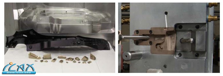

DMLS is often combined with other production methods for one tool, an approach which is
often called hybrid tooling and which can be applied in many variations. For example if only
one half of the tool has intricate geometry, like a mobile phone housing with a simple freeform
outer (visible) surface but a complex rear (hidden) surface with ribs and clips, then it is
often economical to machine the cavity (for the outer surface) whilst building the more
complex core using DMLS. In other cases, only relatively small regions of a tool are so
complex that they cannot be milled.
In such cases it can be sensible to build small inserts using DMLS and machining pockets in
the main tool for these to fit into, either as fixed or loose inserts. An example with a
machined aluminium tool is shown in Figure 6 (left picture), and a similar approach can also
be used with cast epoxy tooling, in which case DMLS inserts are also used for any features
such as thin walls where the epoxy would not be strong enough to resist the moulding
forces [3]. DMLS can also be effectively used to build various other tooling elements. The
example shown in Figure 6 (right picture) used DMLS for moulding cavities, sliding inserts
and also the guides for the sliders. To prevent galling, different DMLS materials were used
for elements which repeatedly slide over each other.

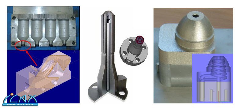

Intelligent tooling concepts also help a lot to apply optimized cooling in a cost-effective
way. Figure 7 shows three examples. Figure 7 (a) shows a blow moulding tool for PE bottles.
The cycle time and therefore production rate of such tools is typically limited by the cooling
time for the necks of the bottles, which have the thickest cross-sections.
In the case shown, small DirectTool inserts with conformal cooling were built to extract the
heat from these regions more quickly, and were integrated into a standard machined
production tool. In this way the cycle time was reduced from 15 seconds to just 8-9
seconds, giving a productivity improvement of approximately 75 percent, with no loss of
quality. 7(b) shows a cooling core designed to be inserted into the rear of the ejector side of
a mould to remove heat from the injection area. This reduced the cycle time in production
by two-thirds. 7(c) shows a core with integrated conformal cooling. The dome includes a
spiral-shaped cooling channel, but the core has been designed so that the lower half can be
easily machined.
In this way, the core was cost-effectively produced by machining the lower part, mounting
it in an EOSINT M270 system and adding the top part by DMLS [2]. 0.3mm machining
allowance was added for finish-machining of the outer surface.
