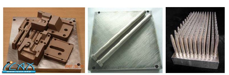

M systems build parts on top of a metal plate called a build platform. When building mould
cavities, the platform is typically integrated into the cavity design so that the DMLS
geometry is melted directly onto the platform. Figure 8 (a) shows how multiple tool inserts
can be built on one platform (these are components for the tool shown in Figure 6(b)). The
individual inserts are cut out, typically by sawing or wire cutting, to produce inserts or
onserts like those shown in Figure 1 and Figure 2. In cases where it is not convenient to
integrate the platform, for example loose inserts or cooling pins, these are built on a support
structure which attaches the DMLS geometry to the platform, and which is removed after
building.
An example is shown in Figure 8 (b), which also shows how long parts (in this case 305 mm)
can be built lying down to save time. Figure 8 (c) shows a case where standardized cooling
pins were being produced as a series product by EOSINT M. Here the most efficient and
cost-effective method was to build large numbers of pins standing up – in this case 200 pins
fitted on one half of a build platform and could be produced fully automatically (unmannedoperation) in just 30 hours. They can be efficiently separated from the build platform by wire
cutting.
