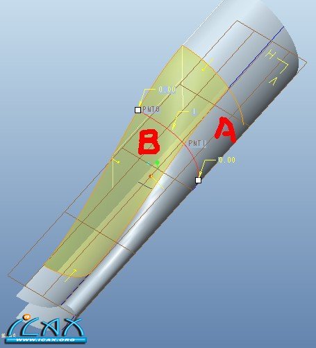

8.再来用造型补齐,a面先补,三边约束相切,b面四边都设相切

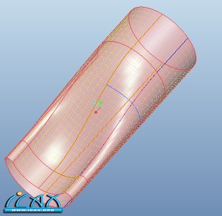

9.再来将面合并,镜像,在合并

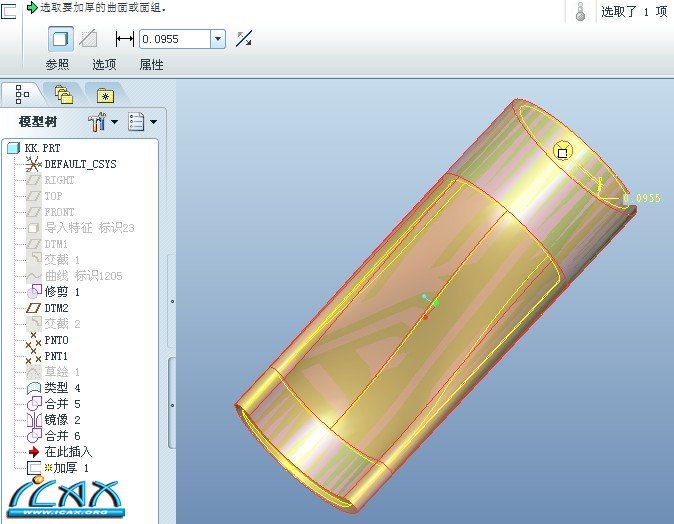

10.加厚0.955

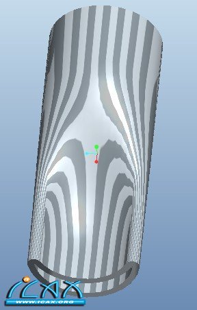

11.斑马纹
