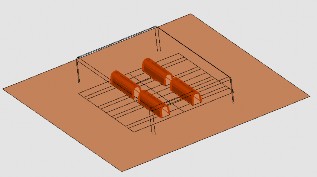

We will start with the cavity 先对行腔部分进行处理
Hide the core plate 隐藏型芯板
Open the Export to Part tool from the Xelerated MoldDesign Guide
模具设计向导中打开输出到零件(Export to Part)
We now need to pick the target part – the active part that the active faces will go into 选取目标零件—分型面要输出到的零件.
You can select the cavity insert from the tree or from the display 选择行腔镶件(从 项目树或显示的行腔几何
体).
The next stage is to select the split direction 接着选择分模 方向:只选择行腔表面的一 张曲面即可全部选中型腔的 所有曲面.在 4 个腔中分别 选一张面.单击确认(OK) Select one of the cavity faces
Note that it is enough to select one faces to get the all the faces of the parting direction.
Select one face from each cavity (4 faces) Click OK
Hide the parting sub-assembly to see the result 隐 藏分模子装配,检查结果
Show the parting sub-assembly 显示分模子装配
We will now transfer the relevant parting surfaces
传送相关分型面
Hide the work parts and the cavity insert 隐藏工作 零件面和行腔镶件
Activate the parting surface part 启动分型面
